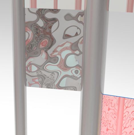

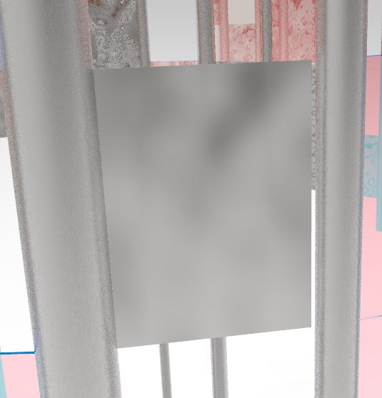

So I have a high polished stainless material with a noise texture (as bump) on a thin (1mm thick) box, it shows on the “front” but not on the “back” side and I cant figure out how to get it on both sides. I cant find any info on this easy query but I hope someone could help me!

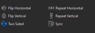

@per.petersson, if you map your bump texture in a planar mode (mapping type) you need to check the “two sided” option ScreenHunter%20322 inside your size and mapping options.
Hi Nick! And thank you for reply! Eventually I found that option! But it took a while.
